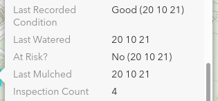

The correct results are displayed in the pop-up on the web map viewer:
However, when loaded in the Field Maps Mobile App (android most recent version), the results constantly change, even though the underlying data remains the same:
I think it's something to do with how the related dataset is being loaded - perhaps the loading is not completed before the pop-up and results are shown, so the sorting and picking functions in the code are running on an incomplete dataset.
