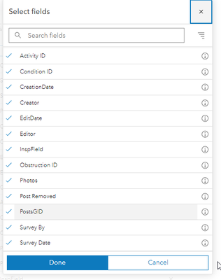

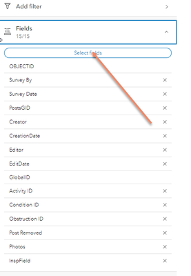

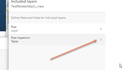

I was able to update my view so that new fields added to my feature class and related table show in the view.
When you ran "Update View", did you specifically go into the feature class AND Stem table and select the "Select Fields" option?
Then make sure there is a checkbox next to all the fields you want to show in the view:
This method works for me.

MiltonSolano
Hi R_,
Thanks for taking the time to reproduce my error. All your steps are correct and those are the supposed steps to update a view. On my case, the view inherited the field for the feature class only; I was able to select the new added fields, but for the related table the new added fields never appeared.
Because our trees are classified in Big, Regular and New Trees, I have 3 exact views from the same FC and related tables. On none of those related table views, the new fields appeared. The FC views showed the new fields but not the related tables.
I finally had to recreate the views; it took me more time to reconfigure the map viewer, Field Map smart forms and so on, but fixed the problem right away. And yes, I use AGO Assistant to copy and paste the JSON definition for the formInfo and popupInfo tag for my maps. It accelerates the process but you have to manually modify some aspects.
Your response is correct although it didn't fixed my problem.
