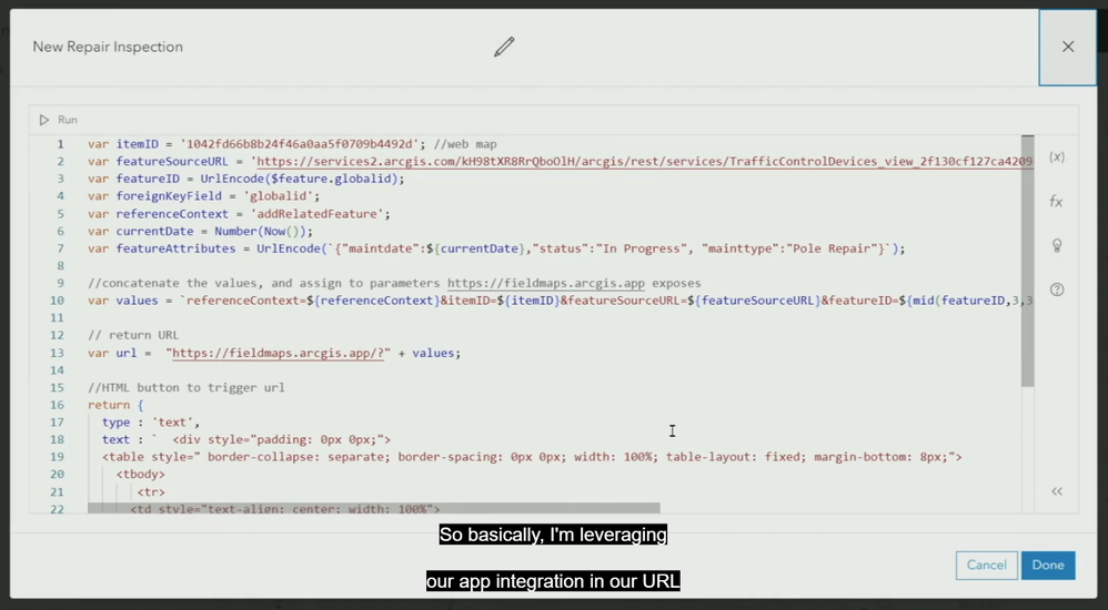

At the Dev Summit last month, Esri showed a way to do this with Arcade and HTML but the presentation missed pieces in the demo that showed all of the code in order to replicate. Recording of the presentation is below:

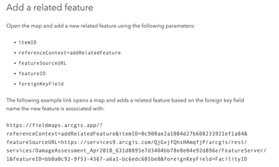

I was able to get a resolution for this workflow, many thanks to meeting with the Field Maps Team during the Esri UC. First this workflow is described on Field Maps documentation that I missed previously.
https://doc.arcgis.com/en/field-maps/latest/prepare-maps/deploy-your-map.htm#ESRI_SECTION1_F7DE2402B...
Here is my final arcade expression that works. In my case, one issue I was having was the curly brackets of my GlobalID field were being "pushed" into the uuid field of my child record table and Field Maps adds those curly brackets already so the link failed without stripping the curly brackets as seen below.

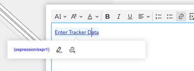

I was never able to get the html button to work like @KeitherPerkinsWSB described. I got the same error message of "Unable to add layer". To get around this and still have a clean button for staff (instead of the long url), I added a text box and created a hyperlink to the expression field.

I think the main thing left out of the video is the rest of the URL parameter in the values variable as well as the HTML code for the button in the URL parameters. I think Kevin was going to do a blog at some point. I'm also working on this these days 🙂 But I haven't attempted yet.

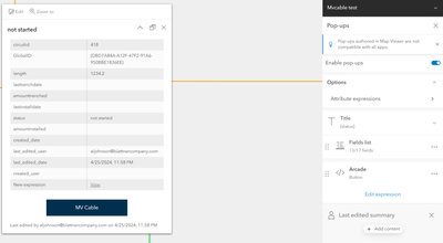

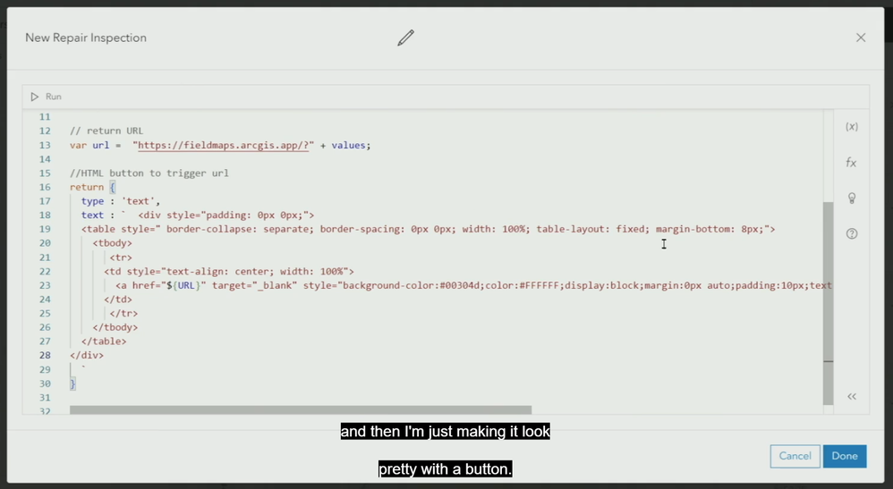

I am also seeing some odd behavior with the HTML configuration for the button from this code. I replicated the HTML portion from this demo to add a button simply pointed at https://google.com for now. When the Arcade expression is present in the webmap it appears in my pop up and is functional. However, when trying to save the map I get the below error.
If I remove the Arcade Expression, the map saves. I cannot seem to find anything where this html code is not supported. Any insight here would be great.
It also presents itself as a 403 error in the F12 console where it looks like the map config cannot be written to the Portal Directory.
I have stripped everything out of the webmap except this single layer, and have the popup config to only have this arcade expression but same save error in a fresh map as well.
//Temp URL for testing button
var url = "https://www.google.com"
//HTML button to trigger url
return{
  type : 'text',
  text : `  <div style="padding: 0px 0px;">
  <table style=" border-collapse: separate; border-spacing: 0px 0px; width: 100%; table-layout: fixed; margin-bottom: 8px;">
    <tbody>
       <tr>
      <td style="text-align: center; width: 100%">
        <a href="${URL}" target="_blank" style="background-color:#00304d;color:#FFFFFF;display:block;margin:0px auto;padding:10px;text-decoration:none;valign:center;width:220px;">MV Cable</a>
      </td>
       </tr>
    </tbody>
  </table>
</div>
