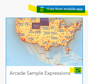

There is a way to prevent the map from showing in Field Maps without deleting it or the underlying data. You can
  • Open Field Maps Designer >
  • Locate the map icon and check the box next to the map title >
  • Select 'Hide from mobile app.'
