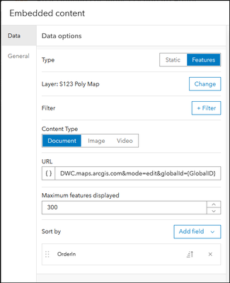

    1. Be sure to use the URL parameters "mode=edit" and "globalId={globalid}"

  4. Embed the form in your dashboard.

DavidMurray_ODWC
I had NO IDEA you could do that with Survey123 forms.
It took me 2 days to pick my way through setting up things as you described.  And it works!!!  😆
