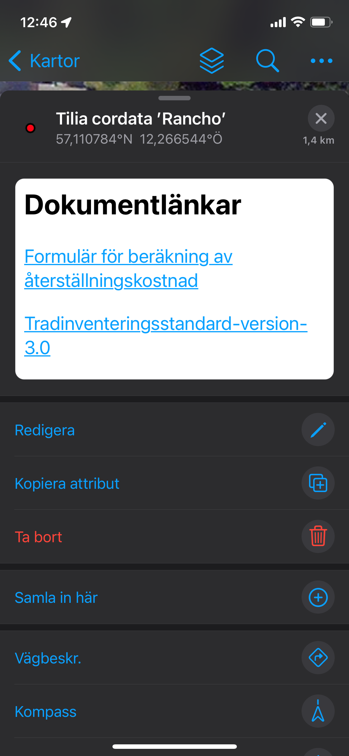

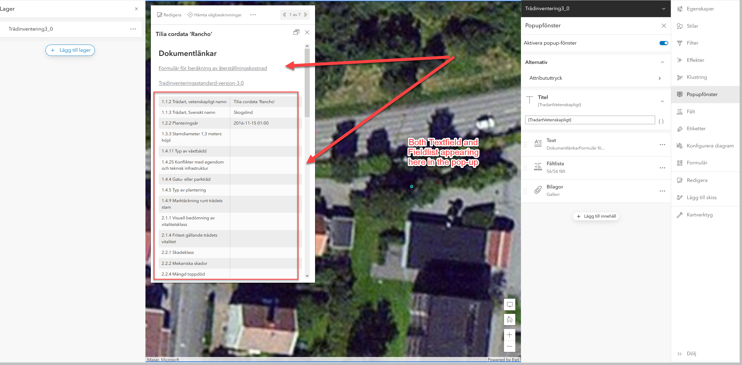

I have created a webmap for treeinspection and configured it in FieldMaps web to get a custom form, eveything works so good but when i add a textfield into the popup in Mapviewer the fieldlist doesnt appear in FiledMaps app.
What am i doin wrong here, if i delete my textfield in the pop-up it works fine.
See my scrreenshots below.
Mapviewer
FieldMaps on my iPhone.

Hi @TimNilsson - the current release of Field Maps does not fully support the multi-element popups that can be configured in the map viewer, which is why you will not see both the Field List and the Text element in the same popup in Field Maps. The good news is that support is coming very soon with the 22.4.0 release this fall. If you'd like to try them out early, the new style popup support is included in our current Beta, you can find out more here: https://www.esri.com/arcgis-blog/products/field-maps/field-mobility/arcgis-field-maps-early-access-r...

I have testet it out and it work just perfect 🙂
