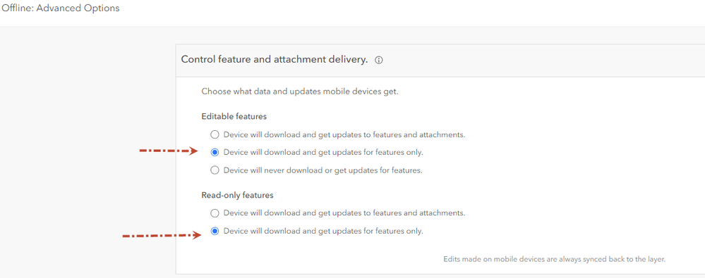

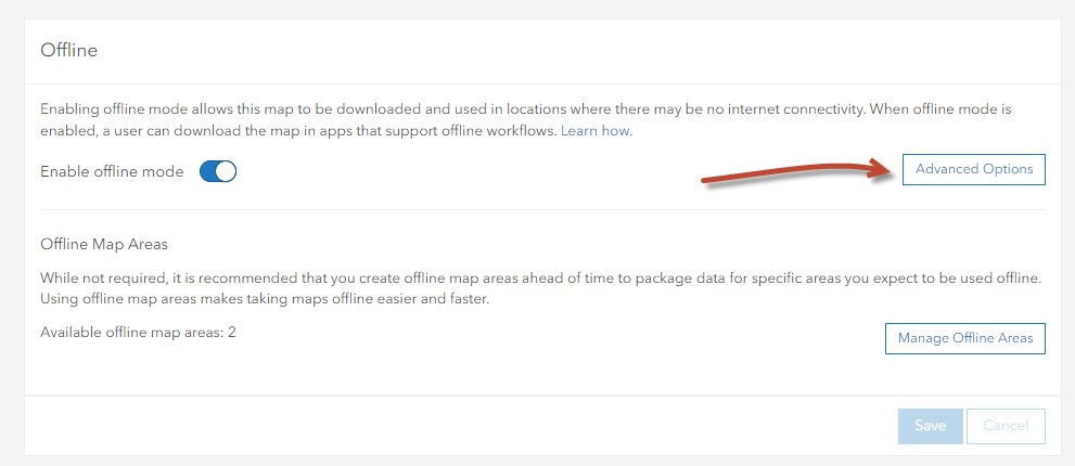

Attachment handling for the map can be controlled in the offline settings - Advanced Options - for the map.
You can control how the device will receive the updates.  The setting below will stop the device from automatically downloading the attachments.
In Field Maps users will see that there is an attachment for the feature, but it will not be downloaded unless the user taps on it to download it.
The feature and attachments are always uploaded.

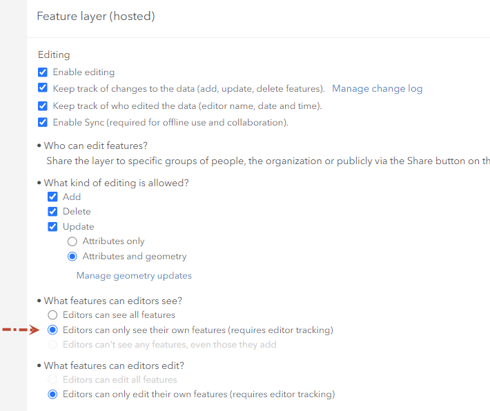

You could also use settings of the feature layer to control the user experience.
In the feature layer edit setting you can also control whether users can see feature created by other users.  Turn on editor tracking and choose 'Editors can only see their own features (requires editor tracking)
LanceKirby2
@MarkBockenhauer when I set the "Device Will Download and Get Update to Features Only" option I don't get any attachments, even the ones I created, within the offline area. That makes sense to me based off the description, but your comment "In Field Maps users will see that there is an attachment for the feature, but it will not be downloaded unless the user taps on it to download it." seems to indicate that I should be able to see them and download them by clicking. Am I missing something?
