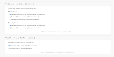

ArnoldTrippel
Hello,
This is how mine is setup. Optimizations are disabled since we have some that use their phones.

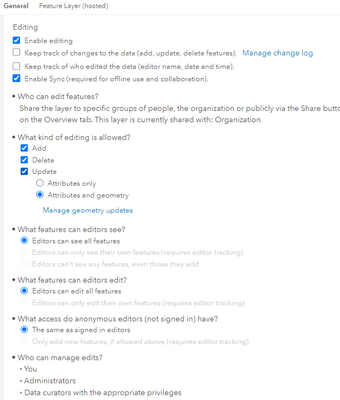

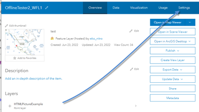

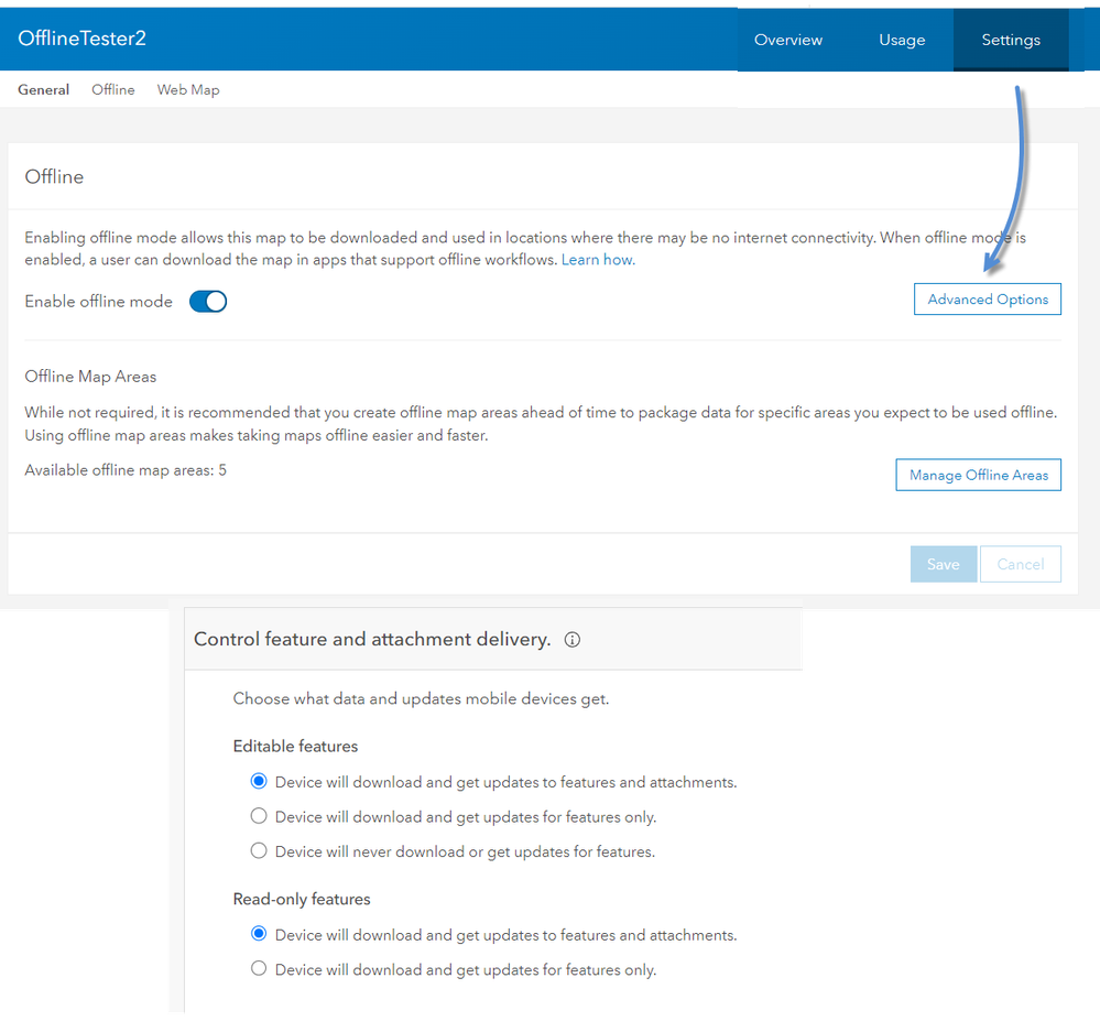

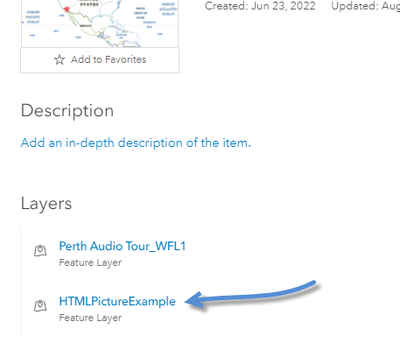

For the editor tracking bit, on the map setting page, click the feature layer.
Then on it item detail page click settings.
on this page you will see the editing options.
These options can also be set when you create the feature service.

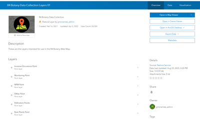

ArnoldTrippel
Okay I see, since I dont own the layer the settings are not showing up. However, this layer is shared with all my coworkers who are in the same AGOL group.
