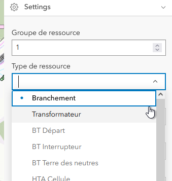

Hello,
I still have the same issue in 11.1
Working with UN asset group as subtypes. I want to publish a service with only one asset group, and a symbology based on the asset type.
I added a definition query to get only one subtype :
Also, for every feature template I specified the same asset group :
But, one published, the asset group field only shows the code (no domain), and the asset type field shows the correct domain, but other domains assigned to this specific subtype do not show in the web editor or map viewer.
Thanks
