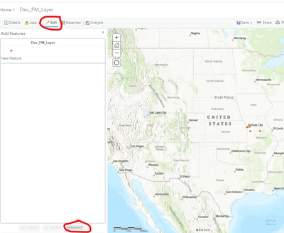

hey Rich,
Edit>Manage>Select Operational Layer>Template Properties>Remove>Save Templates (Note that there is no need to save the map itself).  If you are in enterprise, then don't actually save the map itself as it may wipe your form config; just save the template changes.
Edit Session -> ManageEdit Session -> Manage
Edit Default Value then save templatesEdit Default Value then save templates
* I meant to circle "Remove" and not "Properties" in the previous screenshot

JustinReynolds
hey Rich,

Rich
Hi Justin,
Thanks very much. I found the template properties and removed the ones that weren't required for the layer in question.
