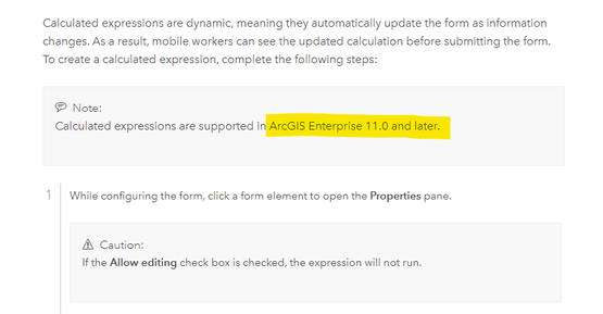

Appears that this 'Calculated Expressions' are not available till 11.0 and later... we are not there yet... sadly we are still at 10.8.1

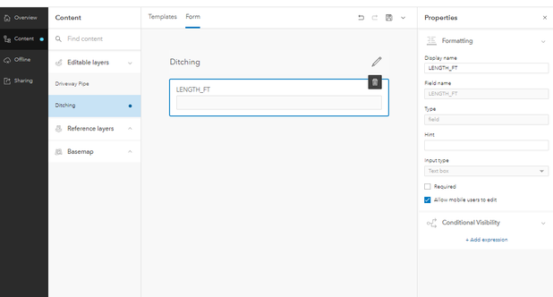

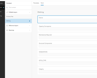

Thanks for your input and help... I go into Field Maps editor and then to the webmap and to the Form section and I dont see anything you are seeing....
Note that once I get to the FORM section there is nothing there... I drag the new field into the form and then this is what I see. I do not see anything regarding Calculated Expressions only conditional Visibility.
kapalczynski
