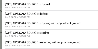

I am using BufferGeodetic() in an arcade expression since our maps are in Web Mercator. When creating line features in Field Maps, the program crashes after adding a single point (i.e. I press ‘Add Point’ once and everything freezes). The Field Map Troubleshooting Log showed the following messages:
