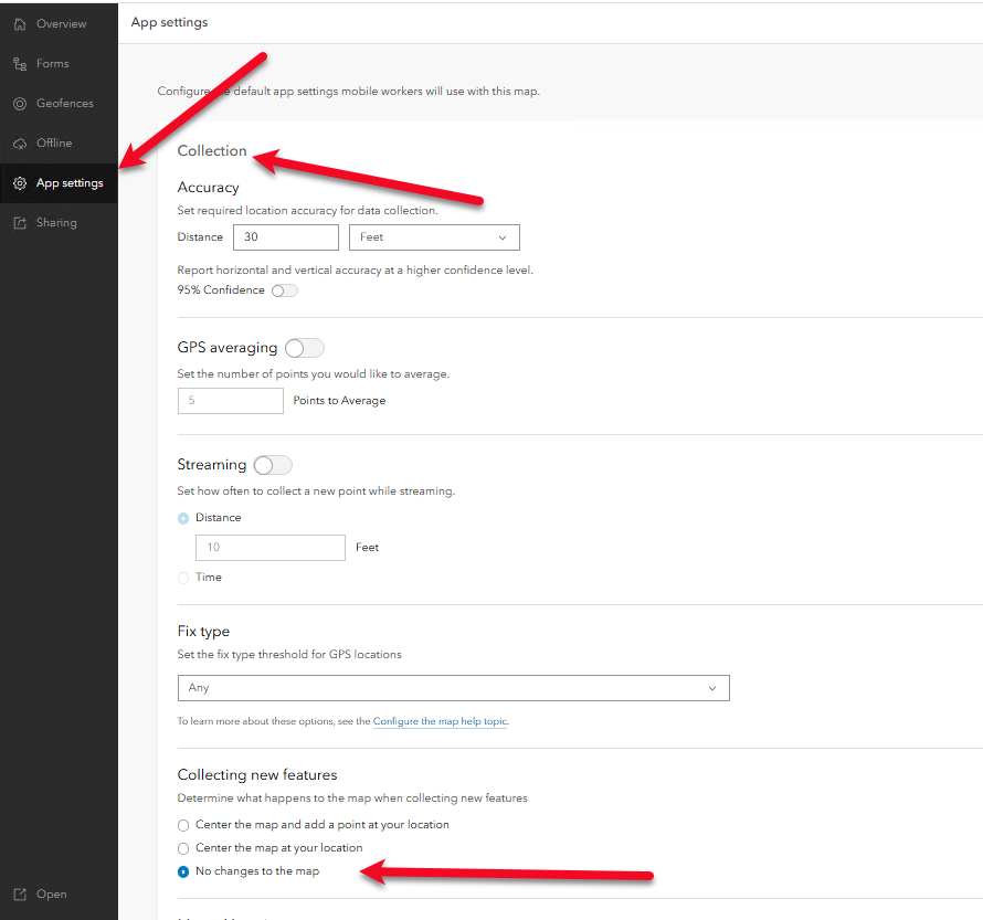

Have you tried this setting in Field Maps Designer?  Not sure about adding related features, but keeps it from zooming 'back' to you when you press the '+' button.  Suspect it would work for the related features as well.
