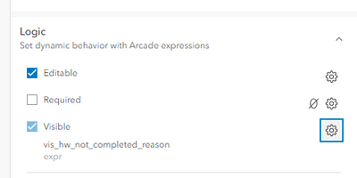

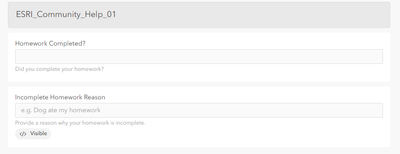

Here I created two text fields to support the example:
I clicked the gear icon next to visibility (found in the logic section after selecting the field "hw_not_completed_reason"). Then clicked add new expression. Then, near the bottom right corner I clicked the "Launch Arcade Editor" Option.  Then I gave my expression the name "vis_hw_not_completed_reason" based on the my field's name.  Then I wrote the expression and saved it.

Thanks, @JustinReynolds This was exactly what I was trying to do. I was using the Calculated Expression cog and not the Visible cog to get at the expression. Appreciate it!
