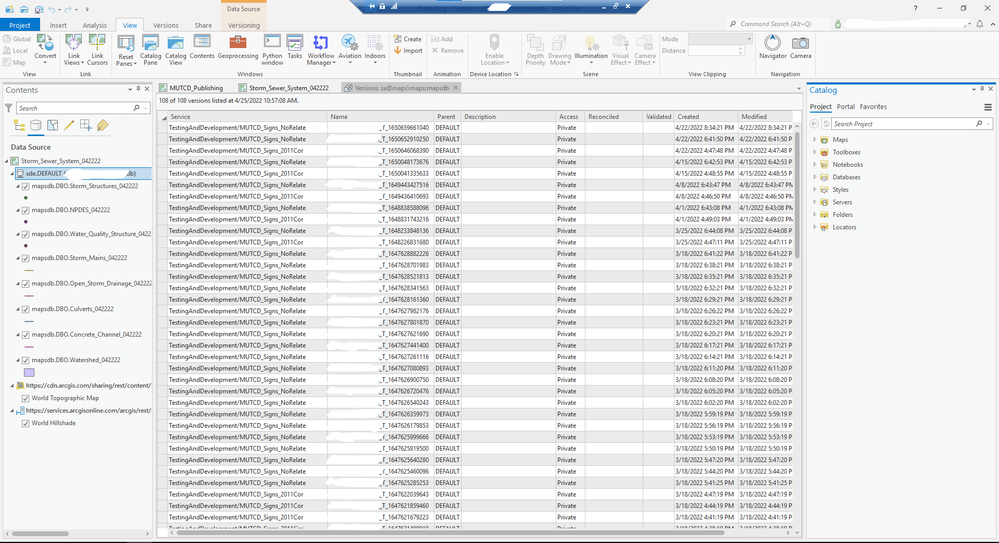

I recently opened the Version Manager in ArcGIS Pro for the first time in six months to find over a hundred new branch versions created since then, on the two web maps I had created for testing.  It looks like new versions are being automatically created at the same time, every week, under my account.
