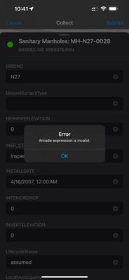

Hi,
I'm trying to edit an attribute on a web service that has an attrbute rule on it.  I'm assuming this error in Field Maps is because of some incompatibility with Field Maps?  Or is something else going on??
In an AGOL webmap, I am able to make the same edit with no problems.

It's just a rule to update a field for our Asset Management system Maximo.  The code works fine, it's just Field Maps that doesn't seem to like it.

if ($feature.FACILITYID != $originalfeature.FACILITYID || $feature.CONTRACTNO != $originalfeature.CONTRACTNO || $feature.LIFECYCLESTATUS != $originalfeature.LIFECYCLESTATUS || $feature.OWNERSHIP != $originalfeature.OWNERSHIP || $feature.LOCATIONDESCRIPTION != $originalfeature.LOCATIONDESCRIPTION || $feature.DEPOTAREA != $originalfeature.DEPOTAREA || $feature.WALLMATERIAL != $originalfeature.WALLMATERIAL || $feature.MHDIAMETER != $originalfeature.MHDIAMETER || $feature.SUBTYPECD != $originalfeature.SUBTYPECD) {
    return 1
} else {
