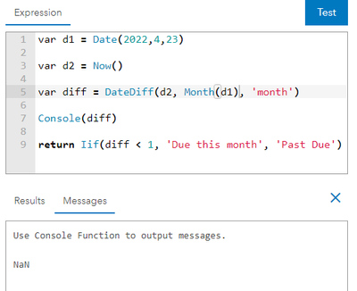

I think the key is "Month($feature["due_date"])".
Month is going to return a number corresponding to the month, whereas DateDiff is looking for two datetime values.
Tip: Make use of the Console function to print out intermediate values to double-check things.
If I was using Month on the other date, I would more easily catch this:

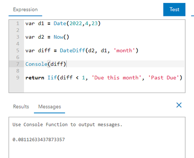

So, just try running your expression against the two dates and leave the Month function out.
Also, when it's a simple either/or, Iif can be more concise to write than a full if... else block.

The reason it's always returning 'Past Due' is the Month function will return a number between 0 and 11. The DateDiff function sees the second parameter as just a number, not a date, so it return NaN (not a number). You should use this:
var DateDifference = DateDiff(Today(), $feature.["due_date"], 'month')
