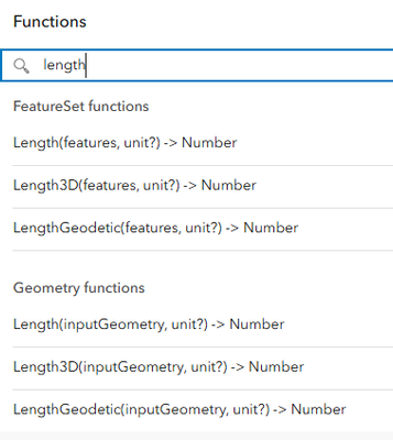

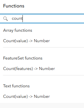

However how did you also know length was not the right function to use?
NathanDavis
Length function only accepts featureSet or Geometry arguments.  Count can accept string arguments, among others.
