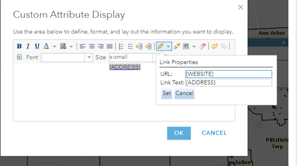

Ideally I would like for them to just click the ID number and have the photo display. I saw this custom attribute display to link properties and I was wondering if this would work for me. If they click on the ID number then that would link them to the photo.  I’m not sure if it would work since first I need to create the URL.

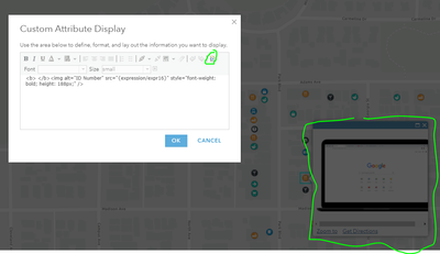

First you need to generate the URL with an arcade expression.  I am using longitude instead of the employee id
Then add a link, with the arcade express as the URL
If you want the image to automatically show in the pop-up you can the source html with something like this
