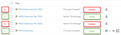

Thanks again @KerriRasmussen for the pointer. I believe this will work nicely for us as a solution. I'm testing it right now. The only part I'm not sure of is what will happen when we run the Vector Tile Package hosted layer update process. As per the screenshot below, we would end up deleting the old Vector Tile Package and the new hosted tile layer after doing the replacement. This would obviously break the link in the Advanced Offline settings to the old vtpk. Do you know what this will do to maps with that file set for offline use?

@LindsayRaabe_FPCWA as a best practice for working offline, I would recommend coordinating your updates with your users. When you get ready to update your basemap, make sure all users have synced any data they have on their devices and remove any existing offline areas. Then once you make your updates to the basemap and add the new basemap to the advanced map settings, users can then download a new offline area which will use the new vector basemap. Since you are making changes to the basemap and not the operational layers, it should be ok if someone happens to forget to make their updates beforehand. But out of an abundance of caution, it's better to treat any changes in offline maps as breaking changes and update only after users have synced their data and removed offline areas.

Yep, I feel more coordination will be needed in the future. I've just done a test run creating an offline capable webmap, uploaded a new vtpk and referenced that in the advanced offline settings. I then downloaded the vtpk with the 1st offline area and made some edits. I've then uploaded a 2nd vtpk and done the Replace layer function on the hosted tile layer and deleted the old vtpk and the archived tile layer. The existing offline area continued to function before and after updating the advanced offline settings to reference the new vtpk and with a second offline area downloaded using the new vtpk (once it had downloaded).
I assume this means that the original vtpk is kept on the mobile device even after being replaced in the webmap? And would it continue to stay on the device after any offline areas referencing it have been removed? If this is the case, I can see it chewing up your devices storage over time with basemaps accumulating.

@LindsayRaabe_FPCWA yes, the original basemap will remain on your device even after you remove the downloaded offline area(s). In order to completely remove the basemap, remove the offline area(s), then log out of ArcGIS Field Maps. When you log back in, any basemaps you had stored that you are not accessing anymore will automatically be removed when starting a new session. You won't have to do this very often, but if you are getting low on storage space, a quick log out/ login will do the trick.

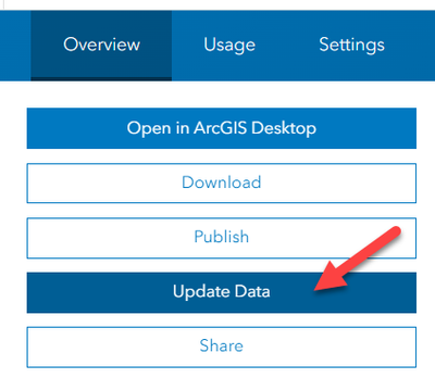

We also experimented with the "Update Data" option on the Vector Tile Package item page, and this only updated the version of the vtpk on the mobile device after all offline areas had been removed and the app closed then a new area downloaded. It would be good if there was a way to push updates to these files through so that users could "optionally" download the latest version (prompted to download an update now or later).
I also struggled to find any documentation around this Update Data function.
