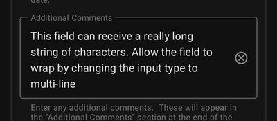

Hello,

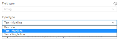

This is already supported.  To implemented it you will need to change the input type to "Text - Multiline" in Field Maps Designer.

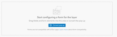

You just need to convert the popup to a form in Field Maps Designer.  The forms can be setup at the web map level.  You will need to be the map owner.  You can create a new map and add the layer of interest to it, if you are not the owner of the original map, then use your map to the data collection.  It just depends on what you are allowed to do.  At any rate it is a quick five minute or less process that doesn't require a change to the schema of your layer.
Then change the input type for the fields of interest from Text - Single Line to Text - Multiline.

The reference to the popup in the previous post is simply to convey that to get started configuring your form in Field Maps you can do so by converting your existing popup.  By doing this, you get a list of fields for data collection based on that popup that you can know configure however you see fit, including changing your a field's input type to multi-line text.

To summarize, text wrapping of text fields in your Field Maps Form is still a thing, but the Map/Form author must decide which fields will wrap and which won't and this is done in Field Maps Designer.
