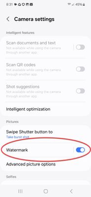

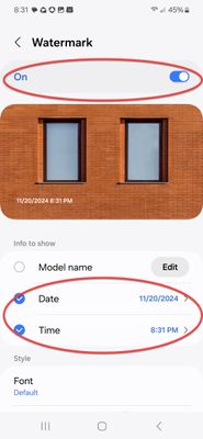

Yes, I agree this is a common limitation with Field Maps, especially if your used to the robust photo watermarking of date time, lat/lon coords, reverse geocoding for address, etc. that can be easily implemented in Survey123 XLSForm.
Here's a workaround in Field Maps we use on Android devices. It's not really "in Field Maps" but because the photo attachment tool from Field Maps just launches the native Camera app on the mobile device you can simply use the camera Settings to watermark the photos with the date/time stamp. You can also toggle on Location Tags in Camera Settings in order to include the location lat/lon coords in the EXIF data for the photos for evidentiary purposes (I don't believe there is a way in Camera settings to also include this coord info in the watermark image with date/time stamp, but that may depend on camera app or the Android or Knox version). We have a fairly limited number of users so we just go thru this one time camera settings on each mobile device as part of our users Field Maps training. Results may vary but this is what works for us:
1. Open Settings in camera.
2. Toggle on Watermark in Camera Settings
3. Tap Watermark in Settings to configure details for watermark [Note: limited options here but something at least]
4. Under Camera Settings, toggle on Location Tags
