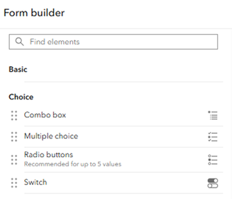

However I have just gone to try and change some of my fields in a form from their current radio button input type to the new multiple choice input type but its not given as an option?
I can see you can add new multiple choice elements to a form (as long as its not a view layer).

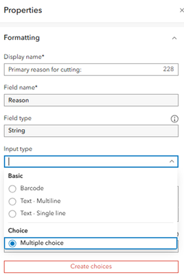

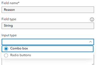

Thanks @AnthonyJonesRSK  I've deleted the domain list from the two fields that I wanted to convert to multiple choice, and one of the field now gives me the multiple choice option (see 1st image below). But the other field doesn't (2nd image below)? as far as I can tell both fields are set up in the same way. Do you have any ideas on why this would be?
Many thanks.
AnthonyJonesRSK
Hi @KatieQuantrell,
I confess I've only dabbled with the new functionality so haven't looked into all its quirks just yet. The documentation is here and there is a line in there that says "If your field has a list of values in it, is part of a contingent value field group, is a primary or foreign key in a relationship, or is a system field, you cannot change it to a multiple choice input type.". I don't know if any of that applies to your second field?
