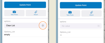

I also encountered a similar problem where I could not update or submit new points after clearing the list.  I tried the solution that @Woodpecker  suggested, and it works, but then after clearing the list the comma stayed at the beginning of the list, and it looked like this:   , yellow, blue, red...
I tried a different approach and added it to the original code. See below.
After cleaning the list, the Options field shows the ‘Clear List’ value, and the Options_List field shows the ‘empty’ value, but if you tap the X in the Options field, it clears them both, and you can then submit a cleared field. See the attached screenshots.
var selection = $feature["Options"];
var thisFieldValue = $feature["Options_List"];
if (selection == "Clear List") {
    return 'empty';
} else if (IsEmpty(thisFieldValue)) {
    return selection;
} else if (thisFieldValue == "empty") {
    return selection;
} else if (thisFieldValue == "Clear List") {
    return '';
} else if (Find(selection, thisFieldValue) != -1) {
    return thisFieldValue;
} else {
    return thisFieldValue + ', ' + selection;
 I hope it helps.
