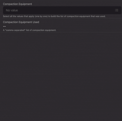

For those looking for another example of the workaround that uses two fields see below.

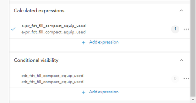

And as a bonus... setting up the editable expression.
1. Create a visibility expression that will instead be used to control editability (which will enable or disable the calculated expression).
Notice the vis condition below that is not assigned to anything.
The editableExpression (created as if it were a visibleExpression).

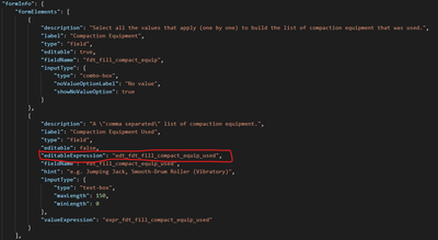

And finally, creating the editableExpression on the field in the web map's JSON using AGOL Assistant.
