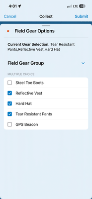

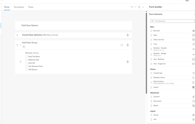

One option that I have been playing around with is to keep the multiple choice question in a collapsable group in the form. You can then expose the comma deliniated list of selected options above the group using the info element. Think this would work for your use case as a work around?
Screenshots for reference:
Designer:
Field Maps Mobile:

Thank you for the reply and solution, this does look like a nice workaround. Unfortunately most of our fields are already grouped and it is not possible to place a group within another group.
For now we have a working workaround with a calculated expression field that sums the options selected in another list but it would be nice to fully use this function without the need for workarounds.
