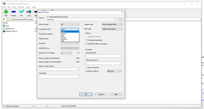

For step 5, I believe Jake is using 7zip to zip the file.
Using the 7 zip app, select the directory you wish to zip and then click Add.  Then change the zip type to "zip" and change the compression level to "store" which is no compression.  If you are using WinZip you can select no compression.
ECanGIS_Team
Using 7Zip for step 5 actually solved the problem. Hopefully Esri will fix this issue so we dont have to go this path 🙂

JakeJacobsAVA
@JustinReynolds Thanks Justin for clarifying and providing the screen shot. That is exactly the process I'm doing.

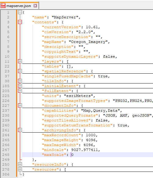

I created a set of imagery and topos for our tracts in ESRI Labs' Tile Package Kreator. These work but have the no overzoom issue.
I have not had luck following the workaround.
@JakeJacobsAVA, would you be willing to provide clarification/details on this workaround.
My TPK includes zooming from 12 to 18, when I open it in Notepad++ and try to follow step 4,
4. Find the one that is not = 0 and change it to 0. , there are multiple instances of maxscale not equaling 0. I have tried changing them all or just the maxscale that seem associated with the closest zoom but I feel like I am grasping at straws.
Suggestions are appreciated!
JakeJacobsAVA
@JonHoch In the mapserver.json file for a tpk the element I needed to change was the maxscale under contents. When I created the tpk it was set to 1128.497176.   Hope this helps.
