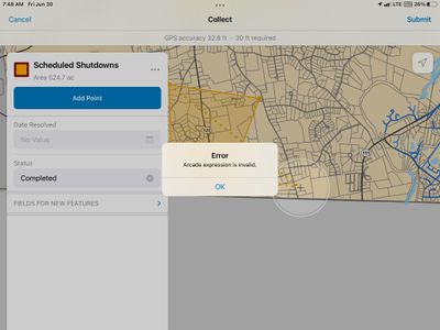

First, in developing and testing Attribute Rules, if there is one that isn't playing nicely with Field Maps, the error "Arcade expression is invalid." displays. This doesn't tell me which attribute rule is invalid. If there's no obvious candidate, the only way to suss it out is by stopping the feature service, turning off one attribute rule, restarting the service, and republishing. If there are more than two attribute rules, this gets very tedious very quickly. Even more frustratingly, this error does not show up in the logs or anywhere else. Listing the attribute rule name or even the code would drastically speed up troubleshooting.

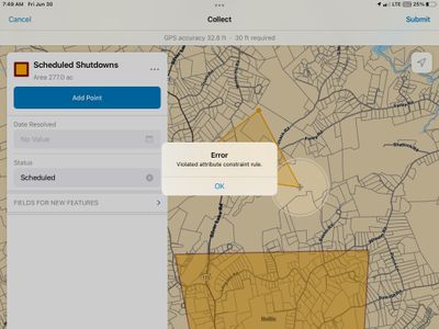

 The second place this causes trouble is with editors in the field. If a constraint rule is violated, the end user doesn't get any feedback about what they need to correct to successfully submit their edit. In this case, the popup should return the custom error message that was set up with the attribute rule.

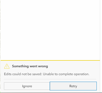

This also is a problem for the Map Viewer (in AGOL and ArcGIS Enterprise 11.4) where the attribute rule during an edit operation that is invalidated does not get presented back to the user:
The only way to see the actual error is to look through the browser network traffic:
