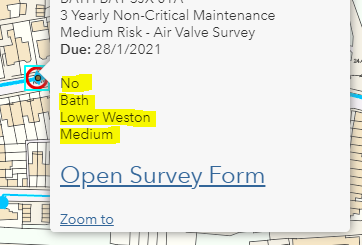

I've just run into similar problems with ArcGIS Enterprise 10.8.1. I have four separate attribute expressions set up which make use of FeatureSetByName. They all just look in another (point) layer in the map to return some info.  Work perfectly in the browser but then in Field Maps iOS client only one of them returns a value. The Arcade code is identical in each expression except for different field names that they return.
Example in browser
Same record in Field Maps
