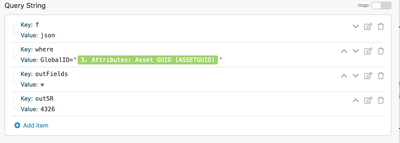

@DEIThat is definitely possible. You'll need to use the HTTP module to make a query request to the related feature layer. You can specify the where clause to be:
GlobalID = '<the GUID for the inspection feature>'
Like this:
It will return an array with a single feature which you can then use.
DEI
You are brilliant @Anonymous User !!!
That is exactly what I needed. I was missing the where clause.

@DEI
Absolutely, I built the Field Maps Integromat app 😀
You can use the Make an API Call module to make an authenticated API request to any federated service (hosted services, basemaps, etc) or to the sharing API (maps, users, etc).
In your case you should reference the "Connect the Make an API Call action to your ArcGIS organization" section of the doc. You'll need to include the sub-domain of "services<X>" when you create your connection. This will allow that connection to make API requests to hosted services. Replace X with whichever number your hosted services are hosted on.
Then you will configure the Make an API module to use that connection and use the relative URL to the query endpoint. The rest should be the same as before. It will look something like this:
We'll have some more blog posts coming out soon to show some scenarios that use this module.

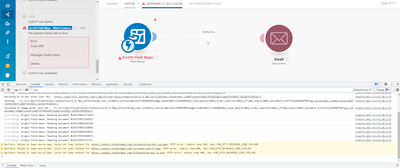

I've been testing a few different scenarios one of which returns an 'Invalid token' error (image attached) every so often. The simple 2 module scenario connects a FM watch features trigger to send an email. When I go to restart, it runs fine for a while and then will send the error seemingly at random. Do you have any thoughts on why it would behave this way?
by Anonymous User
Not applicable

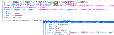

@DEIIf you open the failed run and open developer tools in your browser, you should see messages logged to the console. These messages contain the sanitized requests and responses. Can you see which request is returning the invalid token error?
Here's a screenshot of what I mean.

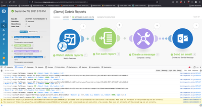

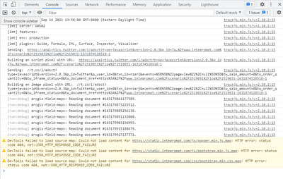

DEI
@AaronPulver
Is this what you're looking for?
by Anonymous User
Not applicable
Kind of @DEI are you opening a page for a specific scenario that ran/failed?
You should see responses and requests logged and objects that you can drill into.
For example, I've expanded the request and response bodies for the generateToken request.
DEI
@AaronPulver
I'm not seeing that on my end.

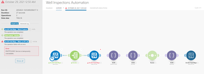

@Anonymous User I followed your blog post workflow for creating assignments in workforce from new inspections, but I'm having trouble with the call API module for Field Maps.
I was able to establish a connection to the data and create email notifications for when a new inspection was created, but when I try to get the create assignments scenario to run I get an error on the call API step.
UPDATE: Integromat responded to my support request. The issue is actually a problem with generating a token by the module, and they've forwarded my request to the dev team. Any advice on possible fixes would be greatly appreciated.
The error is:
ArcGIS Field Maps - Make an API Call
The operation failed with an error.
Error
ENOTFOUND: Service is temporarily unavailable.
by Anonymous User
Not applicable
@JWilsonyeah I saw that ticket come through; I'll look into it.
