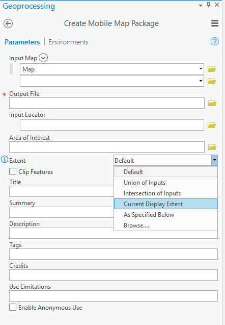

What did you choose for your extent settings when creating the mobile map package (see picture)? I tend to use Current Display Extent, and clip features that are outside this area.
A few follow-up questions though. Does your map have a basemap? Are there visibility ranges set on your operational layers? What happens if you download and open the mmpk back into Pro? Sounds like your default extent is much larger of an area than you intended and the operational layers are not displaying until you get zoomed in to the correct scale. If you can share the map with me I can take a closer look. Feel free to email me at [email protected]

I've tried using current map extent and setting the extent by a feature class layer (CWD_ServiceArea) either way I still have my display issue.
I don't have a basemap.
I do have different visibility ranges set on the different feature class layers.
The .mmpk displays properly when I load back into Arc Pro.
I will email you the .mmpk.
