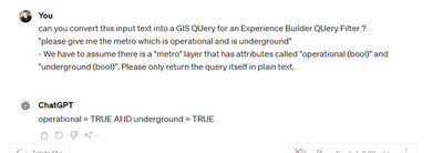

Hi everyone,
This is a simple example of integrating the GPT with ArcGIS Experience Builder.

Hi milesleeaus,
this is awesome. apologies for the silly question, how to integrate  GeoGPT into experience builder? Is it a sort of plugin/widget? thanks
FredericPoliart_EsriAU
Can you share some insight?   I am guessing it must be some custom widget that invokes a custom GPT , feeding it the typed text.  The GPT translates to a filter command aimed at the "metro" layer (green M icons) (ex : WHERE operational = TRUE AND underground = TRUE)
The returned query is then fed to an ExB Filter widget to update its query filter.  (and spawn a refresh Action so the map refreshes it (filtered) layer and zooms-to the location.
right?
It must also have a "railway" layer (orange (T) icons).
but the input text sent to ChatGPT must be also uploading all the layer names, aliases, and all the attributes. (so it can work out what's what)
The GeoGPT1 widget must have config settings with a list of target layers, (just like the search widget has) and of course the CHatGPT API Key and URL
