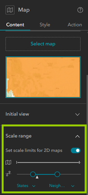

Ke_Xu
by Esri Regular Contributor
Hi All,
This feature has been released on ArcGIS Online in February 2025 and will be released on ArcGIS Enterprise 11.5.
The map bar shows the level of detail(LODs) of the basemaps in the connected maps.
Thanks,
Ke
Boyang_Wang
I just tried it in my existing Experiences and they work very well. Thank you!
