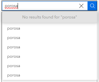

Hi,
I am facing a strange issue here with AGOL ExB search Widget. It is not showing the suggestions when something is typed and only get message "no results found......."
But when you hit enter after typing full field value, Result Panel does not show unique values.
Layer connected to ExB is publicly shared from Portal.
Any hints to solve the issue is appreciated.

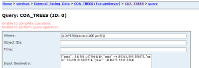

This appears to be a service issue. The query is not supported by the portal layer when both the Geometry Filter (Map - Extent Changes - Filter data records) and Distinction (search suggestion) are applied to the service.
This is a known support issue and you can follow issue BUG-000140112.
