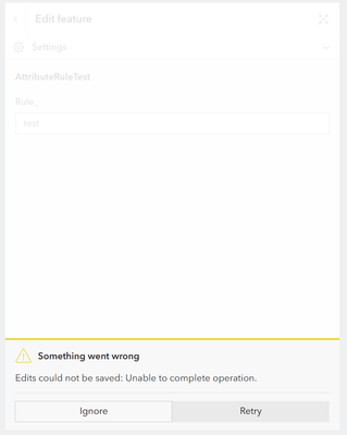

Regardless of the error number/description you provide in ArcGIS Pro, the Editor widget form will only give you a generic error. See screenshot below.
When would the error be thrown? When the value is entered into the field, or when the feature is saved?
The error will be thrown when you click the "Update" button in the ExB form.
