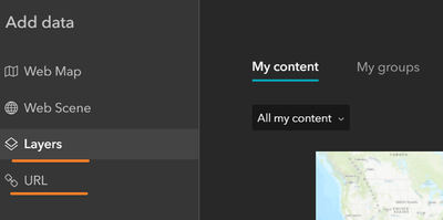

I am not quite sure I understand you correctly, but you can add the feature layer service URL directly in the add data panel:

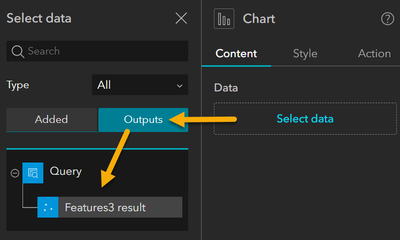

If you were to use a feature layer generated by Query or other widgets that can generate output datasources, just choose the output ds for the desired widget:
