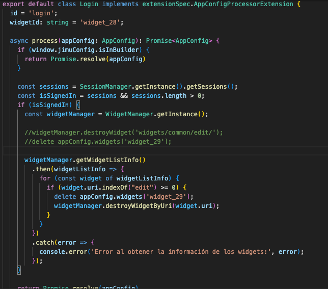

I am trying to hide a widget or widget button if a user is not authenticated but I have not been able to help me how it would be?
I have tried to destroy the widget but it didn't help me.

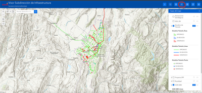

I need to hide this button.
