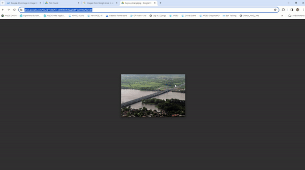

I found a workaround solution by using this link for your image in the Image Widget
https://lh3.googleusercontent.com/u/0/drive-viewer/AEYmBYQwlYjxF9UiOAP-WSrySXINO5Mia0FK8YJoPU3deEUyH...
The way I arrived at the link above is by using the following format first:
https://drive.google.com/file/d/<Image Id>/edit
In your image case will be https://drive.google.com/file/d/1viR6NT-ok4KWnh4tjyg8dJFVeO1l0aAB/edit
Then, I dragged the image to obtain the final link
Hope this helps
