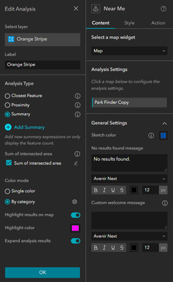

  3. Set the search distance to 0 and turn off all of the inputs.JeffreyThompson2_0-1710247986973.png
  4.  Press Add Analysis and select Analysis type Summary with the selected layer being the flooding layer. By default, the standard analysis is Sum of Intersected Area, so there is the intersected area found.JeffreyThompson2_1-1710248300155.png
