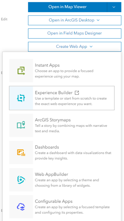

I can't see a similar post on this so just wondering (if anyone else is wondering) why it doesn't seem to be possible to launch a webmap directly into an EB template I've created, on ArcGIS Online?
The webmap has the following app options:
Selecting Experience Builder from this drop-down list takes me to a page with a header that only allows me to select ESRI created templates. There are no other options available:

Is this a hassle? Not really... but it does seem to catch me out everytime! It just seems bit odd that the 'short-cut' to create an EB app straight from the webmap is missing the thing I'm likely to short-cut that map into. So I invariable take this meandering route each time... but maybe that's just me!
Also, side question: what is the difference between an Instant App and a Configurable App? I didn't notice that last one until this screenshot, and now am less clear on the various builders since the start of this post!

@TimF - with regard to your side question about the difference between an Instant App and a Configurable app, this ArcGIS Online community post does a good job of answering that one.
"Basically "Instant Apps" is the rebranded product name for "Configurable Apps" which is a collection of focused apps - this means typically they would only support 1-3 workflows. Apps built with ArcGIS Web AppBuilder typically offered more configuration options and functionality."
The other question about launching Experience Builder from a web map items details page like say ArcGIS Web AppBuilder, I wonder if the Q4 2024 Roadmap Ahead item for WAB mode (a simple builder like WAB) will incorporate this workflow?

Hi @TimF ,
As ExB supports multiple pages and multiple map widgets in one template / app, it is hard to decide whether the custom templates contain a map widget or which map widget should be used to display the web map. What if the map widget in your template has already been configured with a web map? So we only support certain OOTB templates for the web map entrance. To use your own templates, entering experience builder first is recommended.
