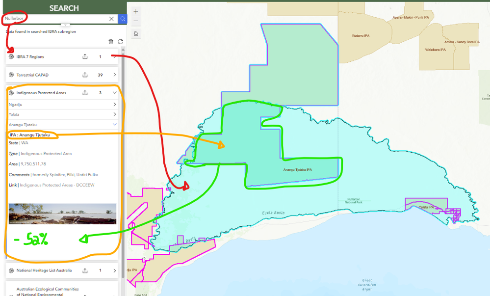

I have built a map with multiple layers of polygon, each representing different datasets. I have created a search function for users to search for a locality. I have a Near Me widget that shows all the different datasets that fall within that searched zone. I then created a query and text with dynamic content, as I was trying to get statistics of the dataset (polygons) that fall within the searched zone. But all I seem to be able to do is Sum, count, average etc for the entirety of the datasets. However, what I am wanting is to get statistics of the datasets for only the sections found within the searched zone.

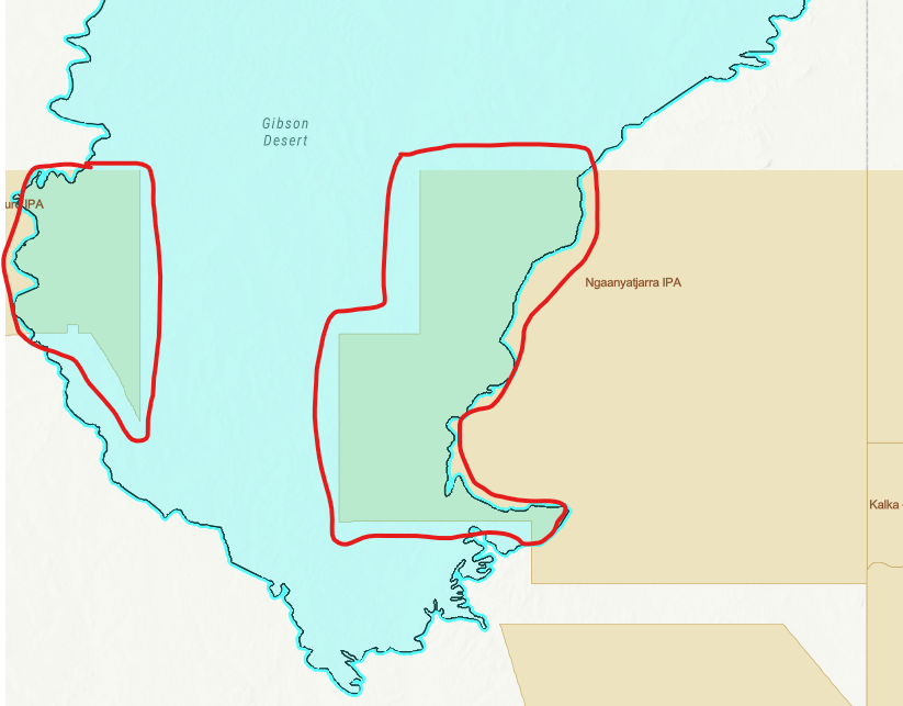

Hopefully this makes sense...but if not, this image might help.
A user searches the area highlighted in blue above, however they want to know how much of the yellow polygons (circled in red) extend into the searched area (highlighted in blue). So, the yellow polygon on the right might be 100 hectares in total, but only 20 hectares or 20% is within the search area.

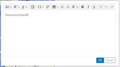

You should then be able to access this number in a Text field by calling the name of the Expression, something like this.

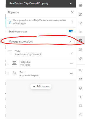

It is possible to get the intersection area/percentage of two intersecting polygons into an Experience Builder popup. Both polygon layers must be loaded into a webmap as FeatureLayers. In the webmap, go to the layer you want the data to display in and customize the popup. Select Manage Expressions then create an Arcade expression. This one should find the total area in acres of a polygon titled 'Easement' within the area of the feature clicked on:
var impact_areas = Intersects($feature, FeatureSetByName($map, 'Easement', ['*'], true))
var impacted_area = 0
for(var ia in impact_areas) {
	impacted_area += AreaGeodetic(Intersection($feature, ia), 'acres')
return impacted_area
Add this expression to your popup and the calculated value should follow your webmap into Experience Builder.

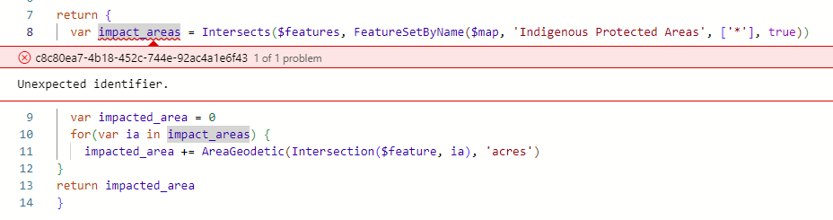

I did try the code and I do get this error -
Have I typed something incorrect or missed something? I'm really sorry as I do suck at coding haha but thankyou in advance for your help!
Matt.
JasonBOCQUET
i'm not sure but maybe because you included your var impact_areas in a return clause ? i think you have not to use a return in line 7

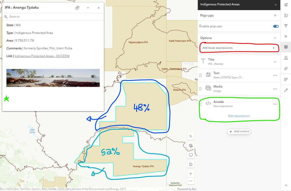

1. In red is the option I have for adding an expression. I see in your screenshot you have 'Manage expressions' whereas I have 'Attribute Expressions'. This doesn't change even when an expression is added; still says Attribute expressions. Is this because of the React of Developer Edition?
2. In Green is where I can add an Arcade expression. We did add an expression and some info was displayed where the Green star is, which is what I wanted. However the code for the intersect/impact areas didnt work.
3. The Blue sections kind of show what I'd like to produce in Experience Builder. Basically the big brown sections are the Indigenous Protected Areas (IPA), and we want to see how much of a percentage sit in the IBRA areas (dark brown boundaries). For example in the blues; dark blue shows 48% of the IPA sits in the IBRA area in the north, and 52% of it sits in the IBRA area to the south.

2. I have then connected the search function to the query list below which shows how many of the others layers are found in the IBRA area. For example, in orange, it states that there is 3 IPAs found in the search IBRA area. Then when the user clicks on the specific IPA they want to view details for, the info is displayed and I am wanting it to show how much of a percentage this polygon is found in the IBRA boundary (bright green example). If users click on a different IPA (Ngadju or Yalata etc which are the other purple boundary areas) it will show full details including the percentage found in the IBRA.
So that's what I am doing, have done and hope to achieve. Does this make any sense, or help with what the Arcade coding should be?
