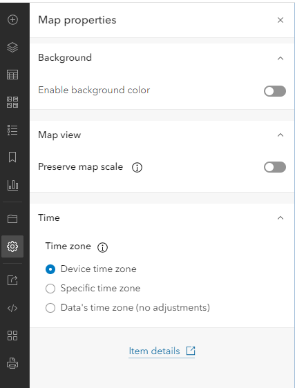

Have you tried using the "Preserve Map Scale" setting on the web map?
