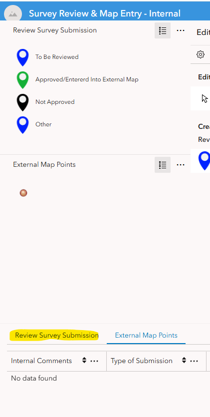

I have two feature layers in an Experience Builder app:
  1. Review Survey Submission
  2. External Map Points
Currently, the External Map Points table opens by default when I expand the attribute table. Is there a way to change that behaviour so it opens the Review Survey Submission layer instead?

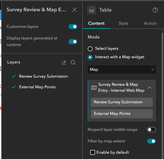

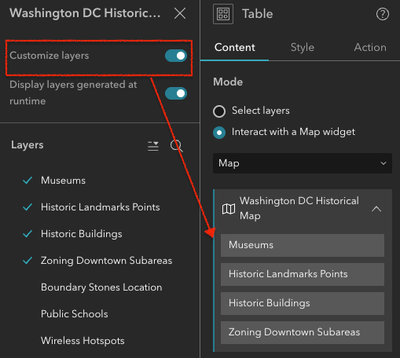

@Bud, is 'Review Survey Submission' layer placed as the first layer in the map layers? If not, you can toggle on 'Customize layers' and reorder your layers in the table widget. The layer sits on the top will appear as the first sheet and open by default in the table widget

@Shen_Zhang Thanks for your reply.

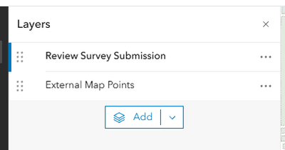

The Review Survey Submission layer has always been the first layer in the web map Contents, so I'm not sure why it wasn't being honored in the Experience Builder attribute table.
I also can't get it to work in the table widget custom properties in Experience Builder. Review Survey Submission has always been first in the list, but isn't being honoured either.
I thought for a second I got it working by removing External Map Points from the table, saving, re-adding it, and saving. But now I can't reproduce it, so maybe I was mistaken.
I wonder if something isn't working quite right with this functionality.
