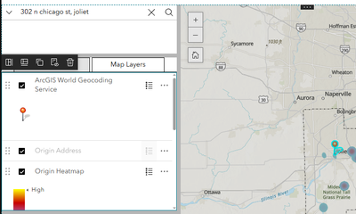

Why does a search point show up in Map Layers widget?

ExB is like whack-a-mole. It takes a long time to get widgets to do what you want. You make one change on one then suddenly that makes a change on another.

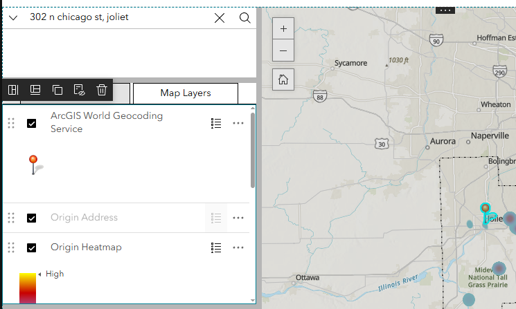

In my Search widget settings I set it to use a custom symbol to show on the map. I thought I was good. But then I see it's showing as ArcGIS World Geocoding Service in my Map Layers. Why and how can I avoid this?

I forgot to mention something. The search point/geocode does not even show up in the Customize Layers list. So I can't uncheck it, intuitively.
TonghuiMing
Hi @JaredPilbeam2, a new option "Display layers generated at runtime" has been provided in AGOL Feb release, and will be picked up by dev1.17. Details you can see https://community.esri.com/t5/arcgis-experience-builder-questions/multiple-map-layers-widgets-and-ad...
