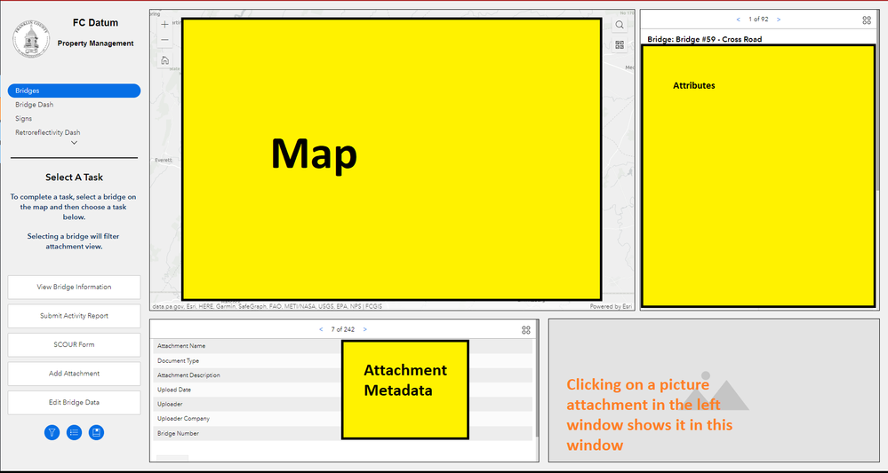

I developed an application for my users to do this via Survey123 forms embedded in the experience builder.  I had a form for attachments where they could upload and windows for viewing any associated ones when they clicked on an existing feature.  Most edits are done in Field Maps but our engineering firm also accesses the Experience to upload inspection reports.  I had to set up additional metadata fields for our attachments so I set up a related table just for attachments on my feature class, published it with attachments enabled.  I then put in a separate window for updating the attachments in the table format.  Not ideal, but since they don't regularly update the attachment information, it works for our purposes.
A separate view has an activity form that they can upload photos to record maintenance on a feature.
In this experience, they click on a feature, and the "Attachment Metadata" window shows all the associated attachments, which are a combo of PDF and image.  Any images when cycling through the attachments will display in the bottom right.
