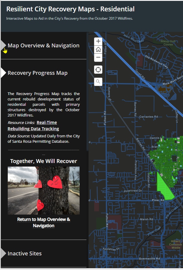

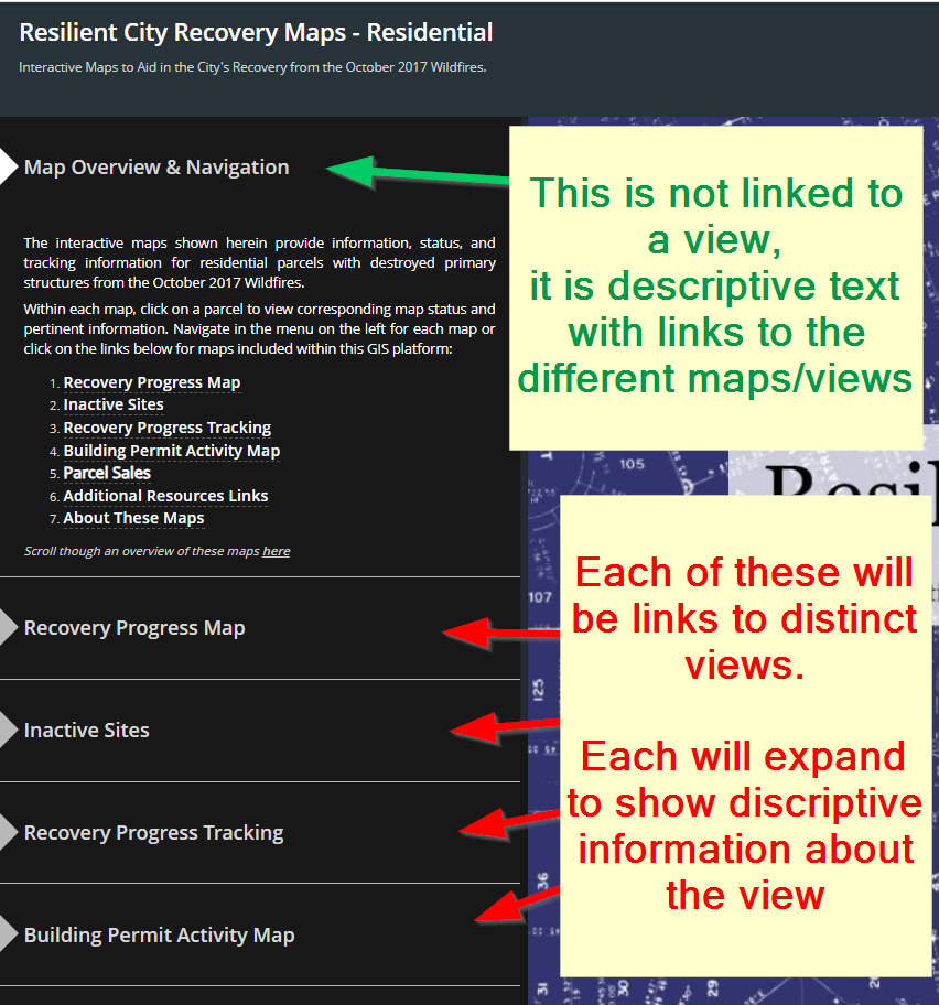

  1. User navigates between different maps via selecting items from a fixed pane on the left side.
  2. clicking a map in the navigation jumps to the map
  3. clicking a map in the navigation expands to provide a description & branding image.
  4. some of the items in the navigation pane are not linked to a map, instead they expand to provide descriptive text (e.g. items: Map Overview & Navigation, Additional Resource Links, About These Maps)

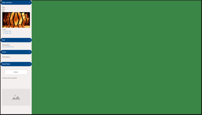

Hi @Joshua_Damron,
Instead of using the Views Navigation widget, I used an Accordion widget to approximate your original app experience: https://experience.arcgis.com/experience/1624a63ce3834b6586168156da8d49ce/
On the left, I added an Accordion widget containing multiple Text widgets. These text widgets can include static text, images, and links to maps. On the right, I used a Section widget with multiple views, where each map is placed in its own view. Links in the text widgets can be configured to open the corresponding view.
However, there is one key limitation: currently, clicking the accordion section titles cannot trigger view navigation. That capability is not there yet. At the moment, views can only be opened via links or actions from widgets such as Text, Button, Card, or the Views Navigation widget.
Given the current capabilities, I would suggest using a Fixed Panel in the bottom-left as a workaround. You can place the relevant elements there and include buttons that allow users to click through to the corresponding views, requiring one additional interaction.
