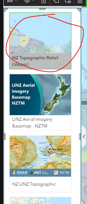

I am using the new basemap widget that became available in the latest release.  I have an experience builder site that uses a webmap for the main map with a overlying feature layer and a basemap.
I've selected a subset of basemaps that I wish to use from my organizational basemap gallery but the issue is the widget is displaying the selected basemaps and also the main webmap as an option in the basemap list.  The main webmap within the widget shows as a thumbnail of the overlying layer but it is labelled as the basemap which is confusing and incorrect!
I have not specifically added the main map to the basemaps list it seems to add it in itself, is there a way to remove it, or rename it so it at least has the correct name?

TonghuiMing
@DeirdreSmyth This is the designed behavior of the Basemap Gallery widget, to allow users to switch back to the original basemap if needed. There is no way to remove it.
However, if you want to rename it, I believe it can be modified in the org/group basemap settings if you are using a designated one.

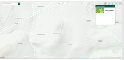

@TonghuiMing, I understand the need to allow users to switch back to the original basemap of the map but the thumbnail is that of the overlying layer so it is incorrect in the basemap widget:
Here I've switched off the overlying layer, you can see the basemap is called Standard Basemap and it is displayed in the main map.  In the basemap widget the Standard Basemap thumbnail is that of the overlying layer and not the Standard basemap.
TonghuiMing
@DeirdreSmyth I believe what you have come across is this case - when the basemap itself does not contain a thumbnail, we will retrieve a substitute from the map widget, which I believe when created has the overlaying layer.
