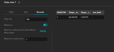

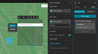

A workaround could be the following:
  1. Create a Data View for the feature layer.
  2. When you configure the Data View, Sort using the field with your values (e.g., ObjectID), and choose to Sort ascending or Descending. In the case of ObjectID, Ascending would give you the smallest values listed first.
  3. Under Records, set the Maximum record count to 1. So now, you'll always only have one record in this data view, and it will always be the record with the smallest value.
  4. Then you can use this Data view in a widget, like the List widget for example, and setup an action to filter all the data records when you select the feature in the List (remember, you'll only have the one feature with the smallest value listed). The fun thing is, you can write any text in the List widget and use it as a filter widget thanks to the actions.

AlixVezina

Hello AlixVezina, thank you for this workaround, it looks very promising and it seems other users are using it successfully. I am stuck on Step 3 and was wondering if you would mind elaborating. I do not see an option for Records when creating a Data View like in your screenshot.
Right now I have the Feature Layer open in the Overview page on AGOL. I click "Create View Layer" > View Layer
I'm able to sort ObjectID by ascending, but do not see an option titled Records that enables me to reduce maximum record count to 1, as is shown in your sceenshot. Could you please elaborate on the steps taken to navigate to the Records options?
AlixVezina
Hi @user74562 , I was referring to a Data View in Experience Builder rather than a Feature Layer view. Here's a tutorial from Esri Canada on Data views: Create Data Views in ArcGIS Experience Builder
