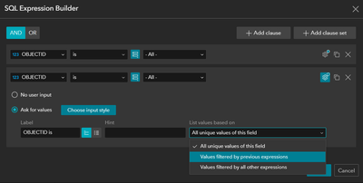

When working with Dashboards, there is the ability to add additional filters on the same panel. Each additional filter or selection is narrowed down based on the previous selection.
In my case, I have Fire Battalions. Each Battalion has about 6 stations. When no Battalion is selected, the dropdown on the Station selection lists 78 stations. When I select 1 Battalion,  the Station selection changes to only those station that belong to that battalion. This does not appear to be in Experience Builder.

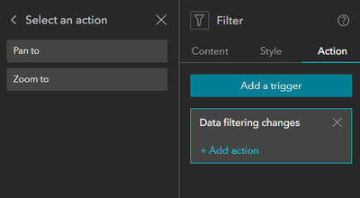

The Zoom-In function was something you configured in Dashboards when there was a change on the selection of layer, you had the option to zoom, pan. I dont see that option for changes on the Experience Builder.

You can configure filters based on previous values like this:
The filter widget's message action (Data filtering changes) was specifically designed to achieve the zoom/pan-to workflow for the Filter widget, and there are more actions for other widgets:
Related version info -
The first is the function included in the first version of the Filter widget (v1.0), and the second has been added since v1.6 (AGOL 9.3, 2021 Oct). If you are using other environments or versions, refer to the following URL for version info:
https://developers.arcgis.com/experience-builder/guide/release-versions/
Hope the doc helps guide you through it, and let us know if you have other questions.
