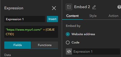

I am using Experience Builder in ArcGIS Enterprise 10.8.1. In Embed Widget, how can I use the expression?
I need to concat my url with GlobalID field. I can't make it work.
by Anonymous User
Not applicable
Hi Azin,
Please try to use quotation marks around the static text.

AzinSharaf
Thank you Shengdi. It is working now.
I couldn't copy the URL from the clipboard into the Expression so I typed all the long url. This is a different issue.

I have tried this for the URL link on a Button widget, and I cannot save the application after adding the dynamic field.  So my parameter isn't passed in. Technically this should work but I can't get this to save in order to test it out.
@Anonymous User any idea how to deal with this?
(Workflow is passing parameters to a webhook that will create a Survey123 report using the Rest api)
ShengdiZhang
Hi, you were still in the editing state before you clicked the Insert button, so the Save button is not enabled.
